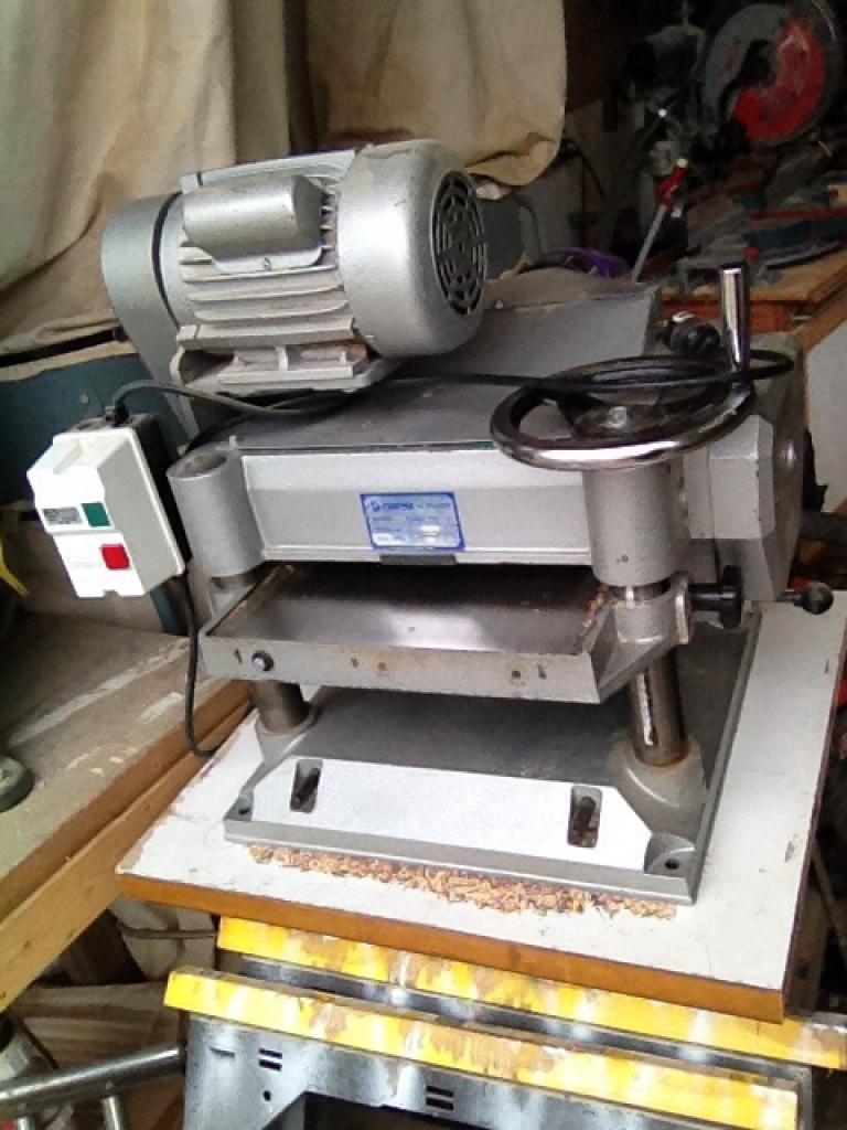

20IN. PLANER WITH HELICAL CUTTERHEAD CSA CX20HC
Manual

This tool produces lots of wood chips. You have to have the dust collector attatched or the chips will jam the machine causing over heating and potential for fire.
Unplug the tool before clearing any stuck chips

Power died mid plane. Unplugged, plugged back in, does not restart
- Ryan Trinder Apr 09 2016

New blades put in. We don't have a blade depth guide for this machine so you have to adjust the height manually. I set a dial gauge on the cutter shaft to zero. Then rotated over the blade and adjusted blade edge so it was aprox. 0.050" above the shaft. Ensure that blade is parallel to shaft and measure both sides. Then check manual for roller guide depth check.
- Zander May 09 2015
