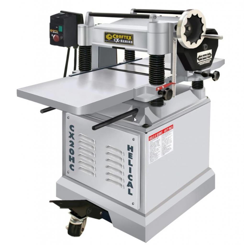

Thickness Planer (Craftex)
Certified trainers for this tool are: Andrew Weeks, Lori Anne Brown
20IN. PLANER WITH HELICAL CUTTERHEAD CSA CX20HC
Manual
Rotating Blade (potential loss of fingers and skin)
This tool produces lots of wood chips. You have to have the dust collector attatched or the chips will jam the machine causing over heating and potential for fire.
Unplug the tool before clearing any stuck chips
MOdel : CX20SC
Motor : 220Volt, 60HZ, 1PH
Serial No. : SJ047
Maintanence Procedures
Helical cutters need to be rotated regularly.
