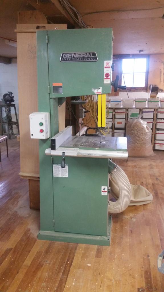

Bandsaw
General International 17” bandsaw.
Important!
Chip extractor must be used or the machine will clog!
Guide arm must be adjusted so that it is no more than 1" above piece being cut.
Do not force the blade when cutting curves! The blade will snap.
Thick blade is for ripping and should not be used for curves.
If you need to cut curves put on a thin blade.

Purchased in Spring of 2019
General Internation 17” Bandsaw
Model :
90-240 M1
S/N :
91961305
HP : 2
Volt : 220
RPM : 1720
