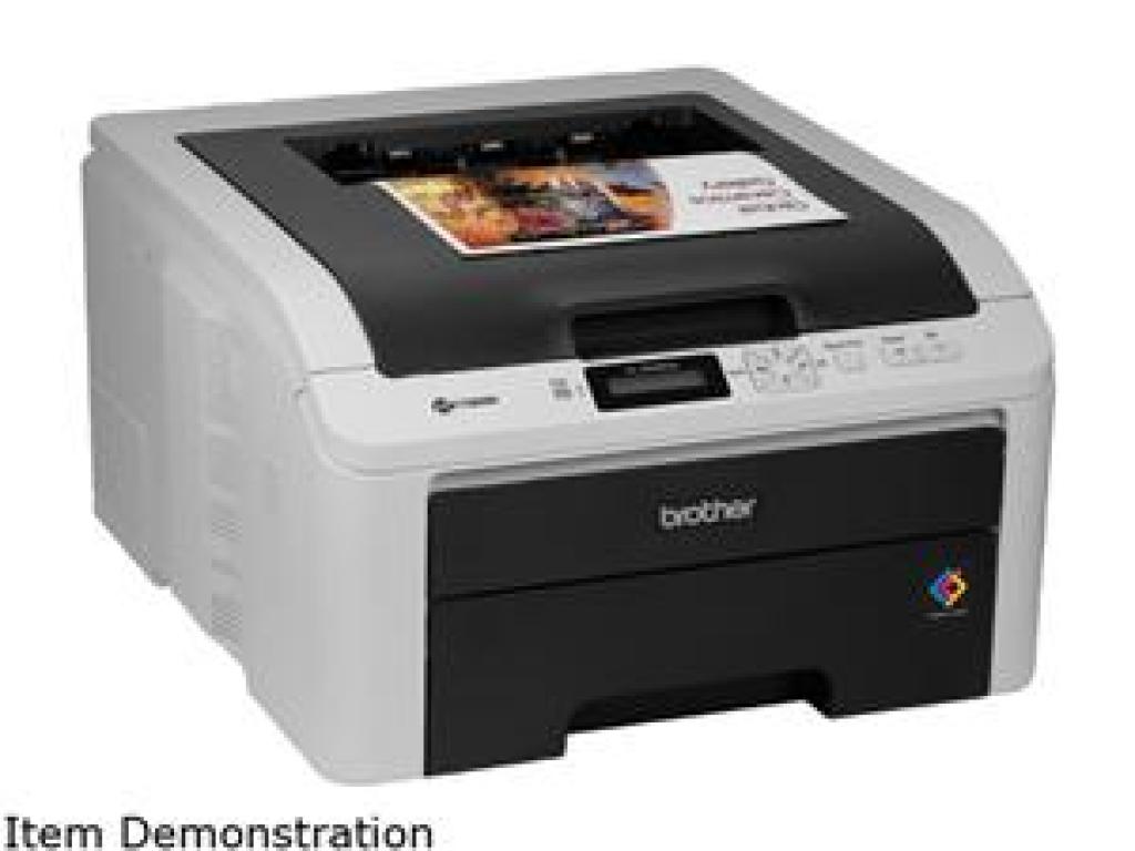

The Brother HL-3045CN colour laser printer is for official DIYode use only. It should not be generally used as the colour toner is extremely expensive.
If you need to use it please contact Simon first.
Takes Brother TN-210 BK/C/M/Y toner cartridges.
