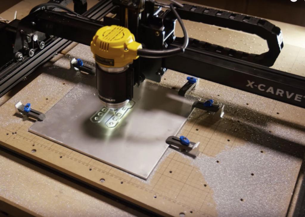

A Consumer grade CNC Cutter with Dewalt Router
running via Easel software from inventables.
Safety Precautions
Ensure work surface is properly secured.
Ensure clamps will not interfere with machine movement
ensure router bit is fastened securely
